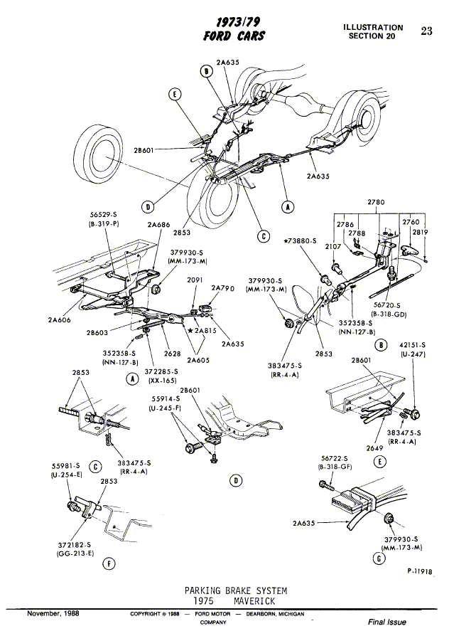

    Now I have a problem I replaced the parking brake cable and I'm an inch or 2 short connecting the cables. My car is a 1975 Maverick 4 door. Not sure what I have done wrong. Can someone send a sketch of the layout of the cables? I can't find them in my books.

    A 4-door also has a short little cable, about 10" long or so, that makes up the difference for the longer 4-door body to use the 2-door cables. Do you have that cable?

    Yes, I have all new cable. The setup is different than a 2 dr.

    A 2-door would be the exact same set-up as a 4-door, the only difference would be that short cable I was talking about.
    1975 would have the foot pedal...so that set-up is different than what has been posted.

    No, the 1975 has the T-handle. The 1976-77 has the foot pedal.

    That's what I have. The problem I have is in where its marked A. I think I might have the wrong cables going the the rear being to short. That's my luck.

    lol....Truth be told, my system has way too much slack in it. It is together enough that pieces wont fall down and drag, but it really doesnt work like it should. Next time I get my car high enough to get under it without a struggle, I plan on taking a close look at it. It is tough to piece stuff together from what you can get your hands on especially when it is your first run at it. Would a second piece of the previously mentioned short cable make it happen?

    See if these pictures of my 1972 help.
    ebrake01.jpg ebrake02.jpg ebrake03.jpg ebrake05.jpg ebrake06.jpg ebrake07.jpg

    I think I'll remove the cables going to the rear wheels and measure them for length. Either I have them reverse or they are the wrong ones. Either way it's going to be painful. That will come later I have other projects to do. Still waiting for my seats to get done.

    For '71 the Ford MPC lists RH cable as 62" & left as 76".

    There to long.
