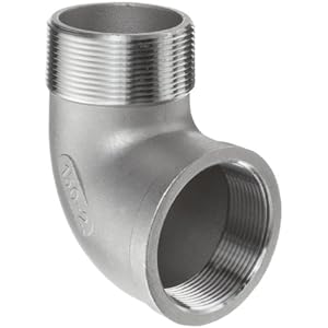

    I ordered the one that claimed to be for Mavericks/Mustangs/Fairlanes. This is a non A/C car. What is a street elbow?

    A street elbow is a threaded 45 or 90 degree elbow. Male threads on one end and female threads on the other.[​IMG]
