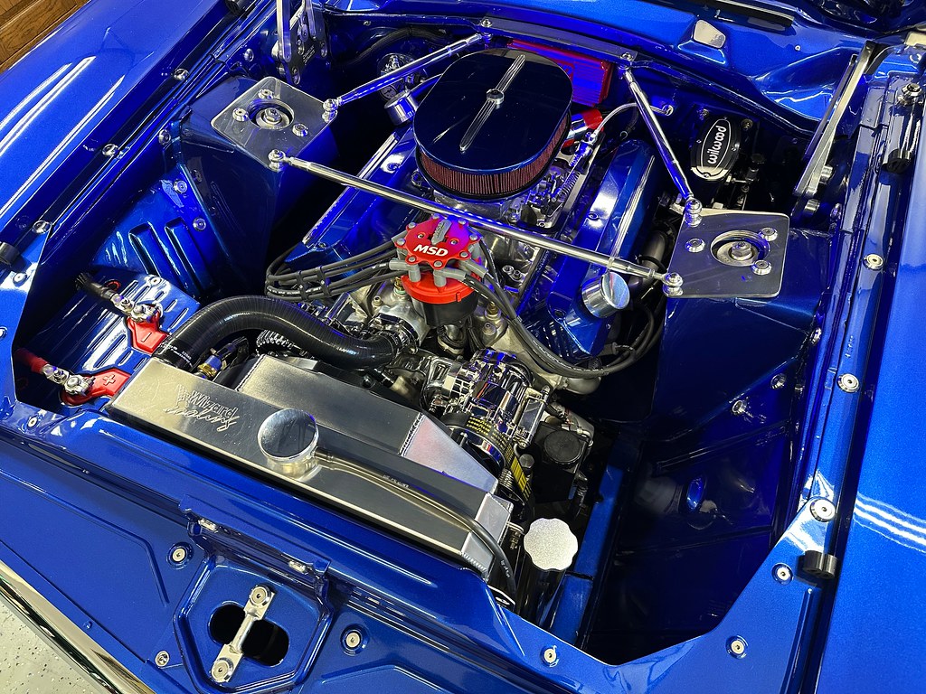

    We could not keep our 347 cool in traffic and not as cool as I'd like going down the road. Ended up buying a Wizard Cooling rad/shroud/fan setup. They build everything at their place in NY. 2 core but their cores are 1" thick. Also the Spal brushless 16" fan is an awesome piece. Not cheap but zero issues now now matter what the conditions are.
