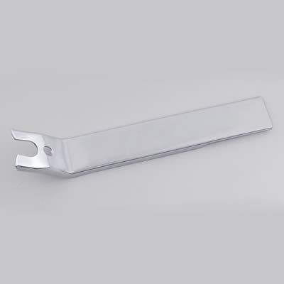

  12. scooper77515
    look for one of these. Or I could mail you mine and let you borrow it, but it would cost as much to mail it back and forth as I paid for it. It is $8 on Summit, I think I paid $12 at O'Reilly.
    I think I paid $16 for a set of V8 seals.

    Scooper, what's that tool? Is that a spring compressor?
  14. scooper77515
    Yes.
    You will need to take off the valve cover, rotate the engine until both valves are closed on cylinder #1, hook the air compressor up to the compression tester and screw it into the spark plug hole, put pressure on it to keep the valves pushed up. Use about 90psi.
    Then use the compressor tool (shown above) to push the springs down, then tap the retainer until it pops down, and remove the 2 valve locks. Don't lose them.
    Let off the spring compressor, take of retainer and spring, remove whatever is left of the old seal, put on new seal, put spring back on with retainer, compress it and put retainers back on.
    Then turn engine so next cylinder has both valves closed and repeat for all the remaining cylinders.
    You may find that the spring tool will force the valve to open causing your compressed air to come out. So just put the tool on the spring and apply moderate pressure and tap the top of the valve with a ball-peen hammer (lightly) until the retainers let loose, then the spring will compress without pushing the valve down.
