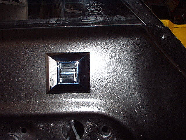

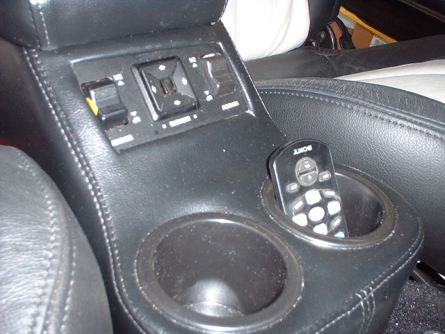

    I have power windows, door locks trunk opener, mirrors, rear view mirror, steering and brakes.. :D
    Thomas Hackmann made the power window regulators for me by welding motor mounts to Mav regulators(as per the article in Shorthorns). I used one of the JC Whitney kits for the locks, and a power trunk release from a Lincoln.... I mounted the switches for the windows and mirrors in an aftermarket center console, and the locks right in the doors.(The locks are also operated by a keypad on the door and a wireless remote)

    Power door lock switch:[​IMG]Power window and mirror switches:[​IMG]
