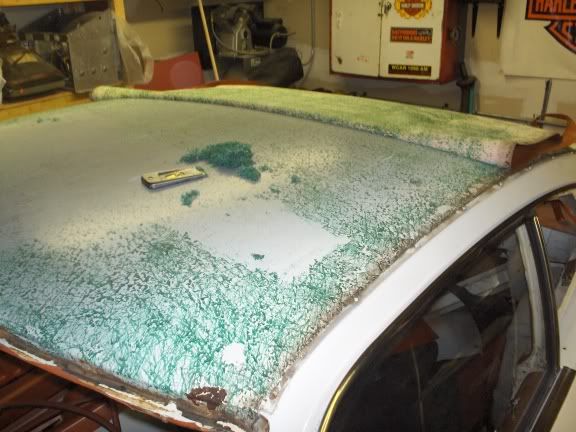

    I was talking to the Media Blaster today, he wants to get my car over there as soon as I can, So tonight I thought I'd pull the Vinyl top off, came off easily, I was really worried about the chrome around the edges, but it came off easy (no bending required) It looks like they didn't paint the roof all the way across at the factory, the white is thicker on the sides, and thins out towards the middle of the roof.

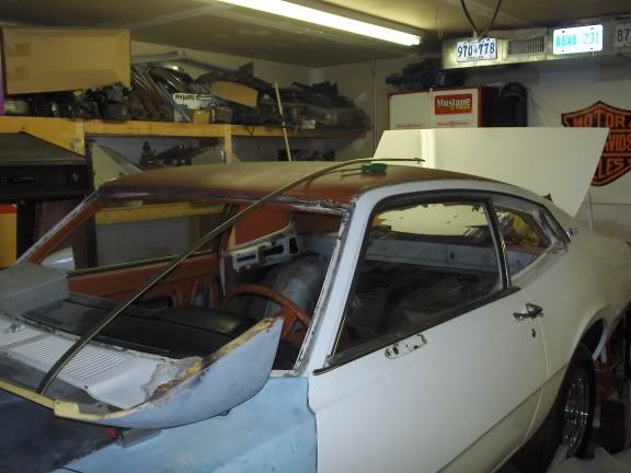

    Another Pic:[​IMG]
  3. 71gold
    26,522
    2,884
    that top looks great to have had a cover on it...most are rusted through (y)
    ...frank...:bouncy:

  5. scooper77515
    Yeah. it looks really good. Usually, the vinyl top acts as a sponge and holds moisture near the steel, causing a rusted mess when you remove it. Luckily, mine was in a garage since 1973, and came off with no rust, but I have heard of guys scrapping the car after removing the vinyl due to the extensive rust.
    Get the glue off, and you might have a semi-easy job getting it to look non-vinyl.
    Hold that vinyl top chrome...it is worth its weight in...CHROME!!!
