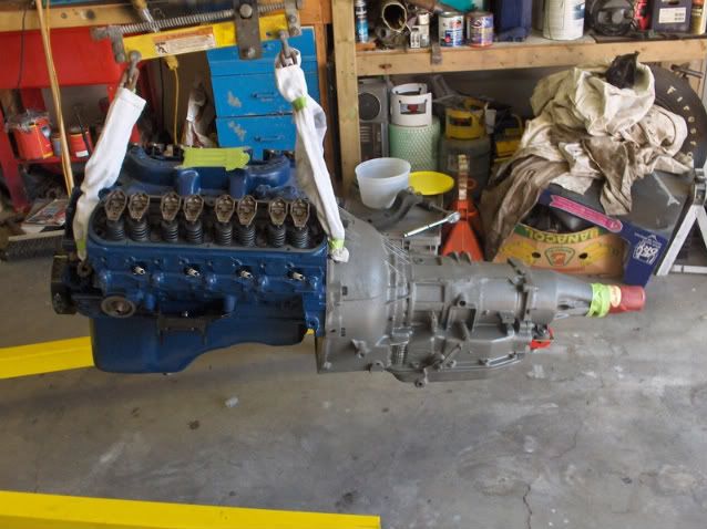

  4. scooper77515
    OK.
    And thanks for the picture...it shows a good mounting point.

    Pull it all together, but be ready for a flood of transmission fluid unless you have a spare yoke or plug to put in!
    I used one of those carb plates when I R&R the 460 in the motor home. I figure if one of those will hold a 460, then a 302 will be a piece of cake.....

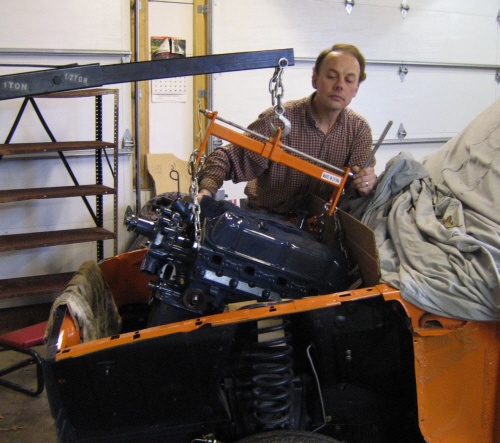

    2,935
    that...leveler...is a must...and extend the arm on the hoist before you pick the engine up...:yup:
    I find it easier to roll the car back from under the engine...less rocking of the motor/transmission.
