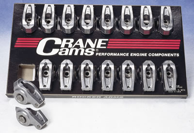

    I am using the Crane/Ford Racing 1.7 roller rockers (pt# F3ZE-6529-AB) and Comp pushrods on GT40 heads with good results.
    These are on a 5.0 block converted to accept a roller cam and lifters.
    They look like this...probably similar to the Comps???:huh:
