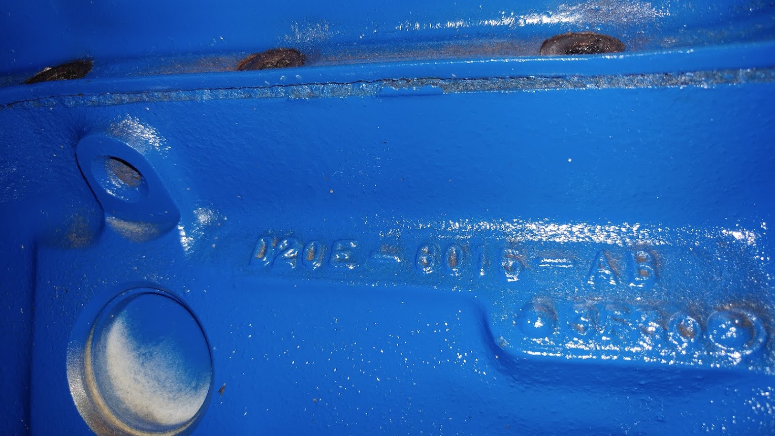

    so i am looking through different rebuild kits, there are kits for 1963-1972, there is 1968-like 1981 or 82, then the rest dont matter to me. my maverick is a 1973 came stock with the 302. original motor. based on the engine code it is a 1972 torino block. i read that it was put in a number of different models up to around 1975.
    so the numbers read--- D20E-6015-AB
    and the casting date--- 3F30
    ok, so as far as i have found the block is a D is 70 2 makkes 72 O is for torino E is for engine
    the 6015 ive read is a ford internal part number :huh:
    the AB is the revision of the block, doesnt mean much to me either
    the casting date 3F30 i have deciphered to be casted june 30th 1973
    ---So my actual question is, is this a 1972 block, or a 1973 block??
    so what matters? the engine code date, or the casting date?

    Ford did not change the casting numbers on blocks, heads or manifolds each year, they only changed when the actual casting was altered. The casting number also does not always indicate what vehicle the block came from. Your D2 block may have been cast in 1972, or any year after until that casting was superseded by another. When you say rebuild kit, what are we talking about, gaskets, seals, bearings, rings; does it include cam and pistons? 289 and 302's for the most part use the same gaskets, seals, bearings, and rings. That is why some kits will say they cover both engines. If you are preparing to rebuild the motor, you may want to define what your goals are for the rebuild. Are you wanting a stock rebuild or are you looking for increased performance? As you say, when dropping a few hundred bucks you want to be sure. Early 70's were transitioning from performance engines to economy, thus the main difference between kits will probably be cam and pistons.

    6015 is basic part number for a engine block, every block will have this number. The remaining digits ID it displacement, differences from a similar engine(such as 4 bolt main, boss 302 block) and original year.
    As far as Torino, my orig '72 engine has same number. Each part is assigned to a division and then generally used in every carline till maybe next change and part could be assigned to a different line.
    As mentioned year isn't really important, minor changes occur, such as front main seal installing from outside cover vs inside. A big change was when rear main changed from two piece to one piece but that didn't happen till early '80s.

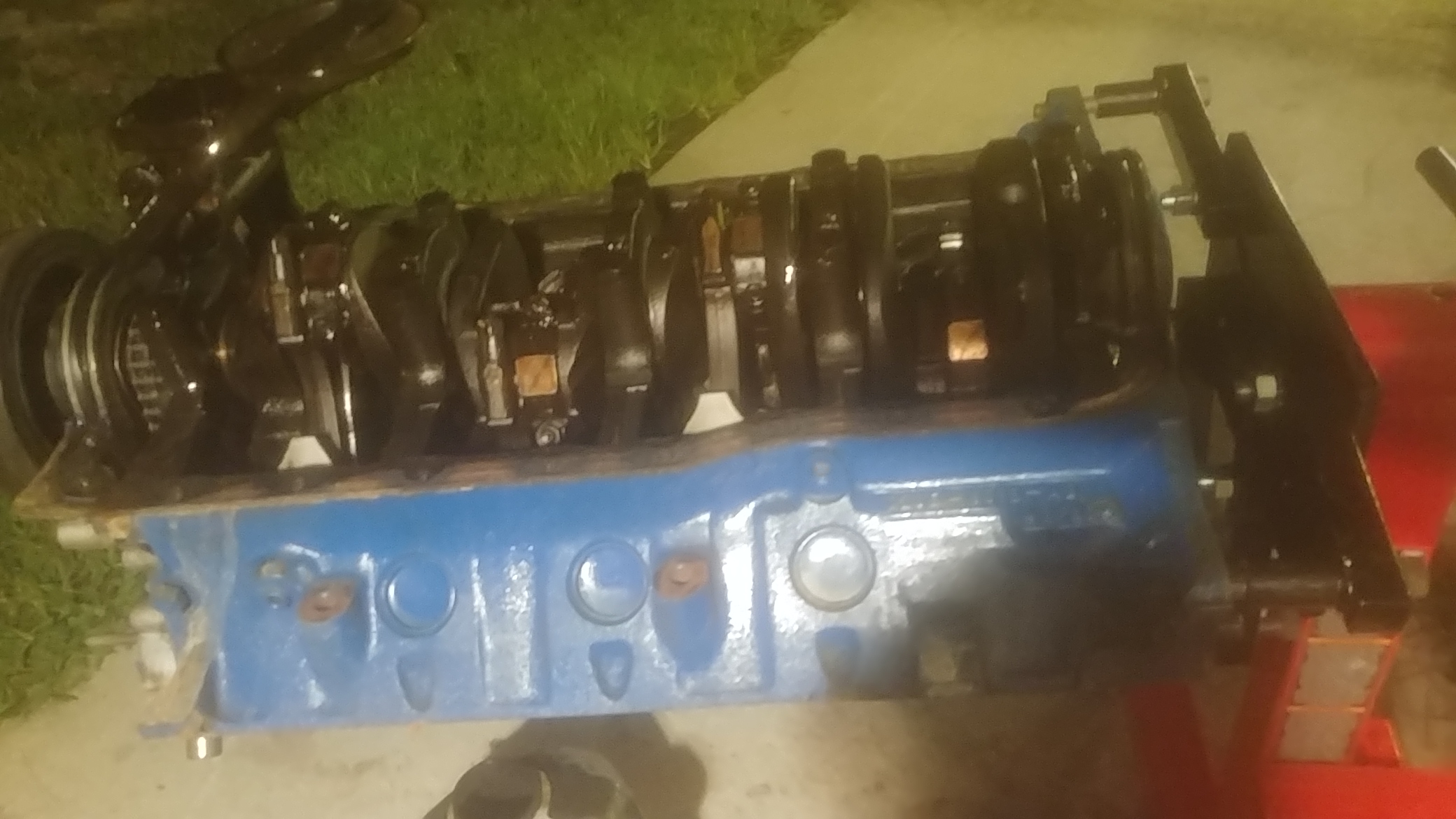

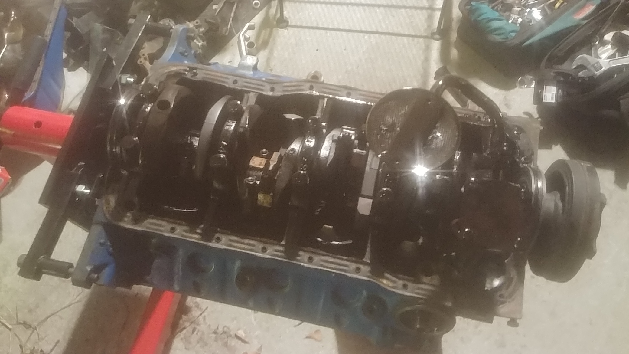

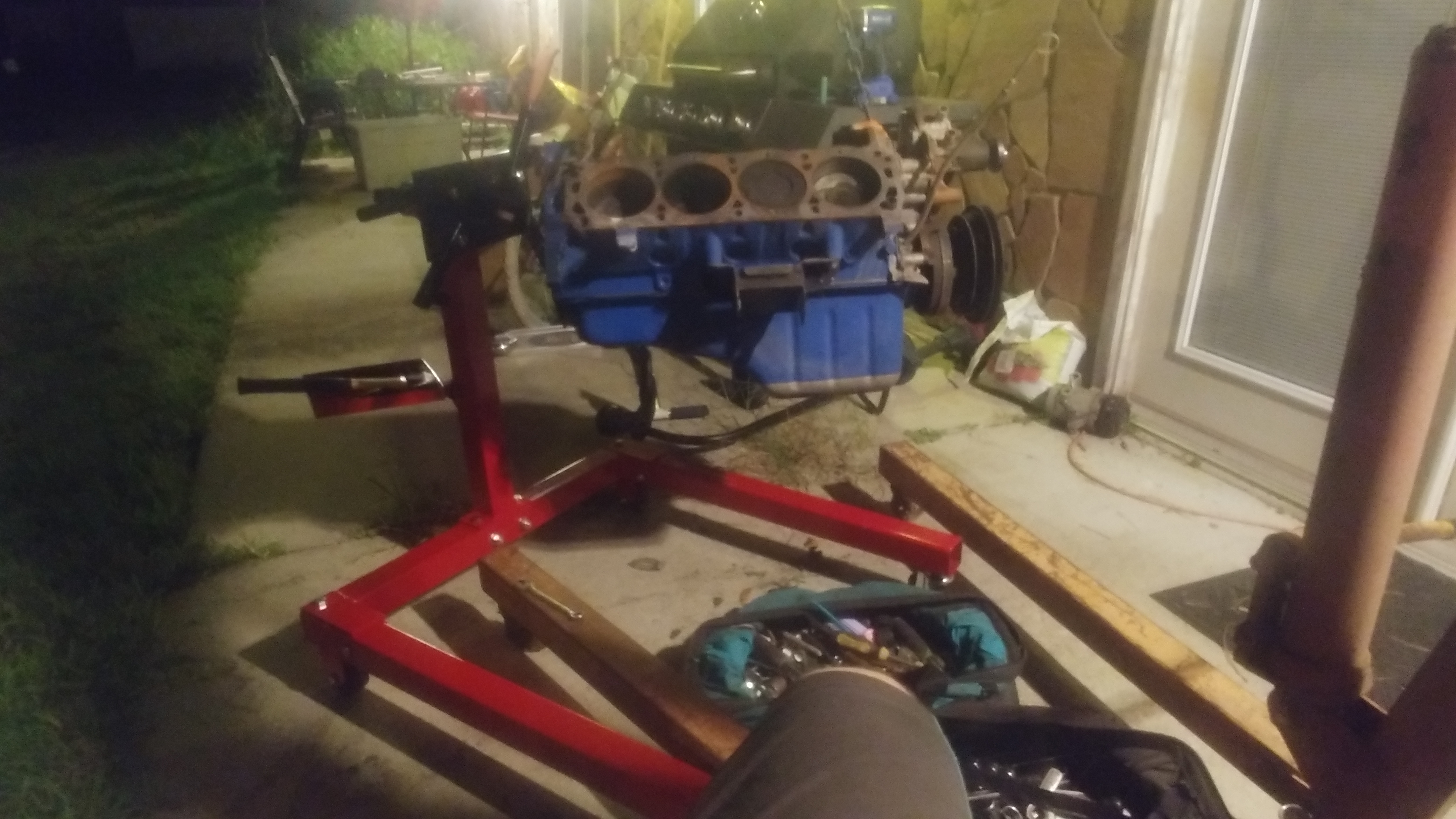

    [​IMG] [​IMG] [​IMG] [​IMG]
    I also got the oil pump, pistons and rods out. i also got the old gaskets off and scraped clean. gave it all a wipe down, and covered it up for the night. i have to dig around for my harmonic puller. tomorrow i will remove h. balancer, timing cover, timing chain and gears, cam, cam bearings, and the crank. i think thats about all. i planned on getting it to the machine shop today, but i work slow, and take my sweet time. low stress guy here. some call it lazy i call it zen :happy:
