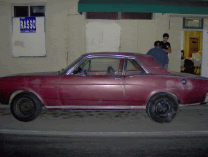

    Im goin to buy the raptor one made by i think magna flow, they are about 15 or 20 at kragen.My dadsfriend has them on his mustang and they sound very deep but he doesnt have any pipe after the mufflers he just has the inlet connected.I think i will be buying these tomorow or the day after, when i do i'll upload a vid.I wish i had a vid of my uncles 200 is sounds soo good cant even tell its a 6, cant remeber what he did but it was something like using a diesel type muffler then adding something that makes it louder,i'll ask him when he comes by.
    I might have some pics on the PC let me look for them...
    Nope dont have the underside pics,But know that i think about it, i think he used a bigger pipe after the muffler cant tell what size but heres a pic.

  9. Mavaholic
    Funny looking Mustang :D must have had the rare Falcon package. :D

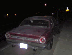

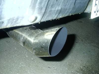

    Spoke with my uncle and this is what he did:
    (sounds like daves idea)
    Started off with the stock 2" pipe coming from the manifold down below the car about 2',then he used a reducer backwards to make the pipe to 2 1/2", the muffler he used was the Flowmaster(40-S) that they make for firebird/camaros where it has one inlet and two 2 1/2 outlets, then he finished it with a 3 1/2" (6"s long) tip on the 2 1/2 pipes.
    I'm going junkyarding with him on wednesday so i might be able to get a vid of the falcon.It sounds very good, but then again i havent seen it since last thanksgiving, but i remember it sounded better than my old V8 set-up.

    :rofl:
    Actually i think some falcons look better than some mustangs, i cant belive how long its been since i've seen his falcon he sent it to the paint shop a while ago.I remember when he used to live with us and i always saw his spending so much time on his cars i used to think he was crazy spending so much time on it even sleeping in it sometimes....Look at me now:D
