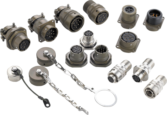

    You can't beat the price and durability of J/Y factory connectors, the others shown are top notch, but very expensive...
  14. mav1970
    I used to build and install the electrical portions of new bucket trucks/digger derricks for Altec Industries. I used a lot of these type connectors and they are top notch. Great solid seal and most are waterproof too. Some of these are in my plans for my own car :)

    yea but trying to order them online isn't easy, it's something I will get to install the engine harness once the EFI is ready to go....
