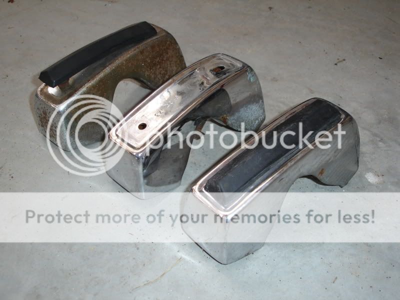

    These say 70 Maverick Rear Bumper Guards. Will they fit on a 73 Rear Bumper?

  2. Dave B
    Do you know the part number? 70-73 used the same rear bumper, but in 73 the bumper was positioned further from the body of the car. I have some 73 rears, but I'd have to dig them out to see if they are the same.

    1970-1972 Maverick/Comet rear bumper guards are TOTALLY different than 1973 Maverick/Comet rear bumper guards.
    Those look like Pinto guards to me.

    These are 1973 rear bumper guards:
    The attachment bolts for the '73 are not directly horizontal, like the ones in your picture. You can see the bolt in the center guard.
