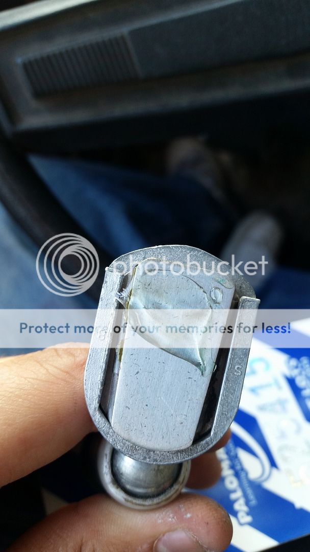

    Which adhesive have you guys used to glue your rearview mirror to the windshield? I used this permatex adhesive yesterday. Later on the mirror fell off and it chipped the windshield. I figured maybe I added too much adhesive so I cleaned it up and bought the same adhesive again. Little did I know the same thing would happen again, except this time a nice chunk off the windshield stayed on the metal button. It hurts to mess up a perfect windshield doing something so simple as this.

    I'd say you used too much adhesive that over heated during the curing, can't think of any other reason it could bust the windshield...
    On second look I don't think you have the correct button for that mirror, it's to narrow... If the mirror mount wedged against the glass when you tightened it, I can see it prying a chunk out of the windshield...

    That actually makes sense. How can I find the right button for it? Or should I buy a new mirror?

    The buttons of old were straight sided, while the newer ones are trapezoidal shaped like the one you have... Mine is currently opposite, straight button, angled mirror... Which from looking at yours should mean my mirror won't fit on button, but it too is a bit large for button... I plan on dissembling another mirror I have with bad glass and see if I can use that mount on the later mirror(appear to be same internally)...

    What i dont understand is that I glued the button twice last year and i didnt have an issue until now. So I didnt really pay attention to the button I thought it was the adhesive. I bought a mustang 68 69 reproduction mirror yesterdsy and the button looks like as soon as I tighten it up the same thing is going to happen. Ill post pictures of the new mirror in a little bit.
