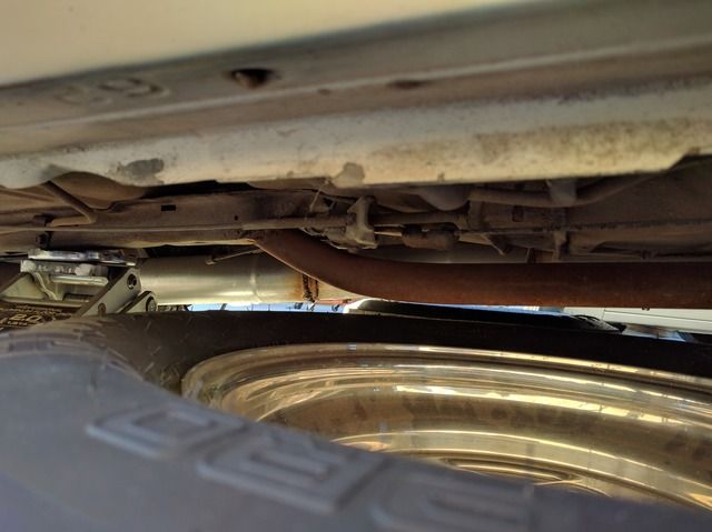

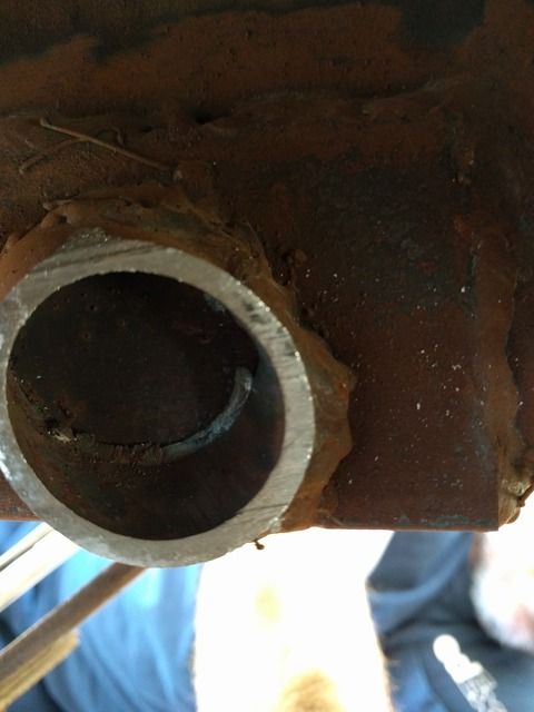

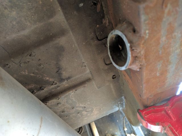

    So today I moved the car to the back yard and proceeded to pull off one leaf spring.. Like I mentioned before, the car has some sort of home made subframe connectors and they terminate right where the access hole is for the front leaf spring eye bolt.. So, I had to cut them off to access it.. only to find that after cutting off the section of SFC I find they also welded a plate that I now have to grind and hole saw thru....fail
    [​IMG] [​IMG] [​IMG]
