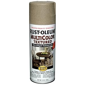

I saw some painted on a mustang yesterday... the guy used. To each their own.. to each their own. He also used it in his trunk and floor boards...to cover the rust. Probably will do a cheap paint job myself until I can afford the 8k one I really really want. As that yellow cracked and ..not peeling oddly enough paint has to go..
