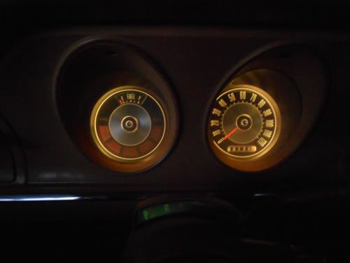

    You can disassemble the cluster and paint the inside of the housing white and you will achieve this with standard bulbs! I like the amber better too! Notice the very dim shift indicator. It and the ac controls will get the treatment next! :thumbs2:
