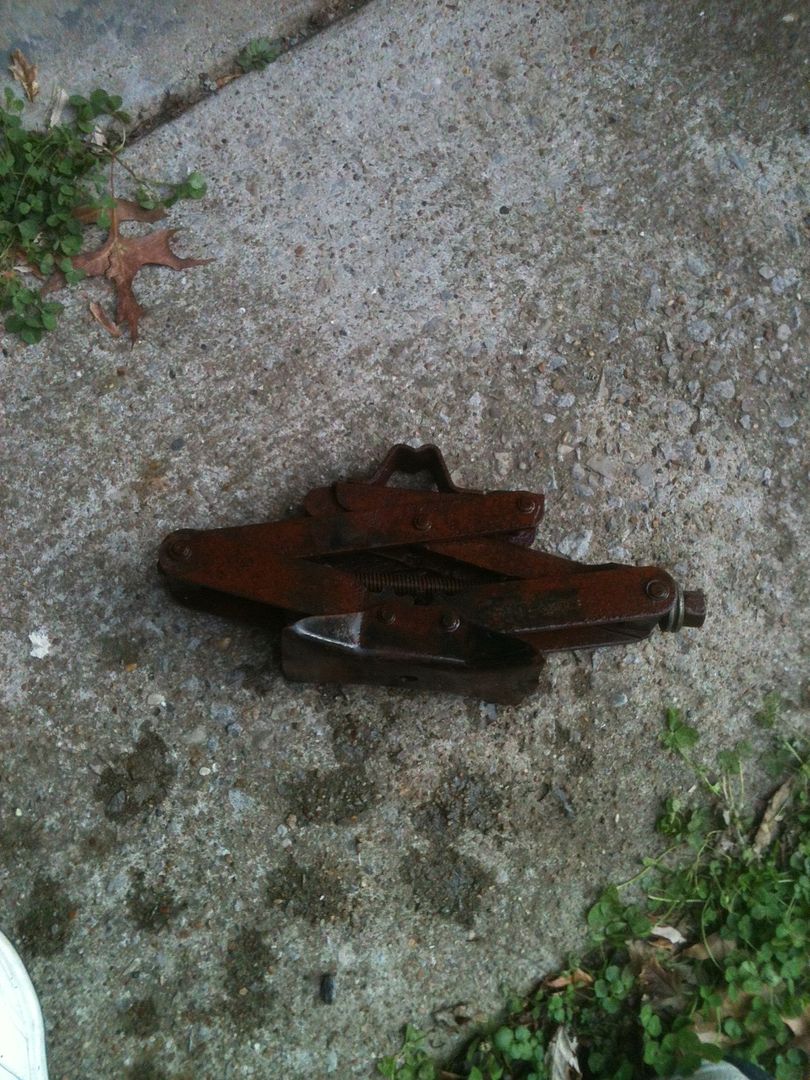

    The mice peed all over my jack when I had the car stored since the 90s so it's pretty rusty. I've always wanted to try vinegar so here we go.

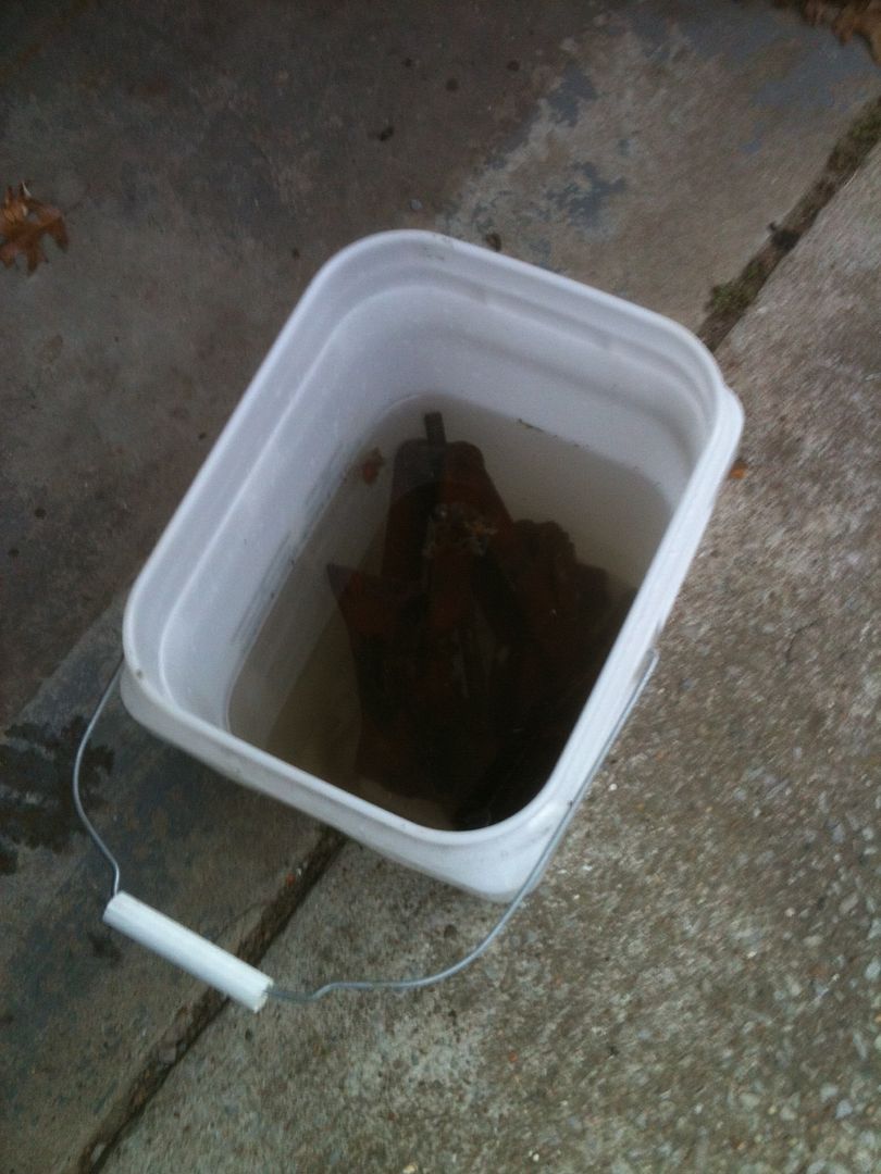

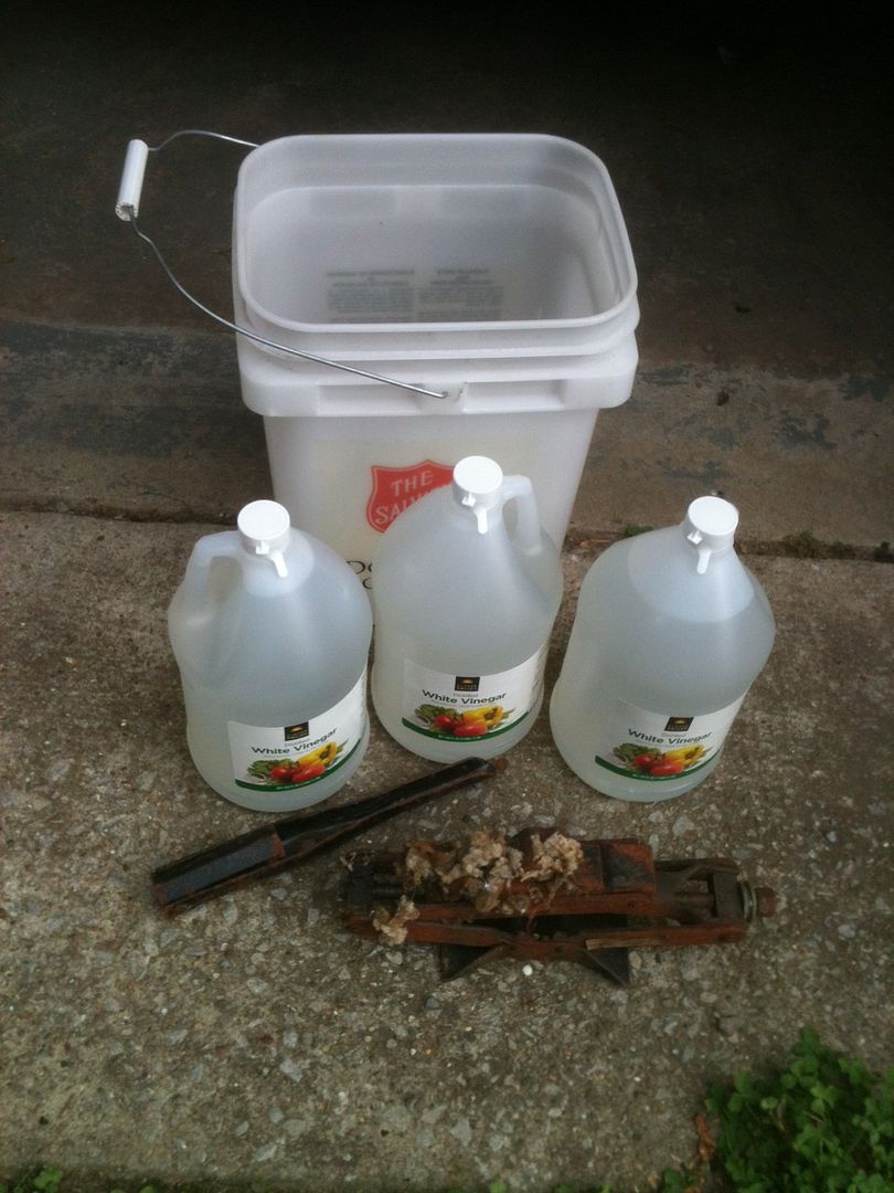

    The mixture...a bucket and 3 gallons of vinegar. A jack and handle.
    Hosed the mouse nesting off a little.
    Now time to wait....will update. :whistle:

    Took a look this morning and there are bubbles coming off the jack so somethings happening. Just wanted to try this as an experiment. I recently saw when someone had bought an old that had alot of rust on the roof. They covered the roof on fabric and kept applying vinegar for several days. Appeared to work very well.
    Gonna leave it till maybe Wed. or Thursday.

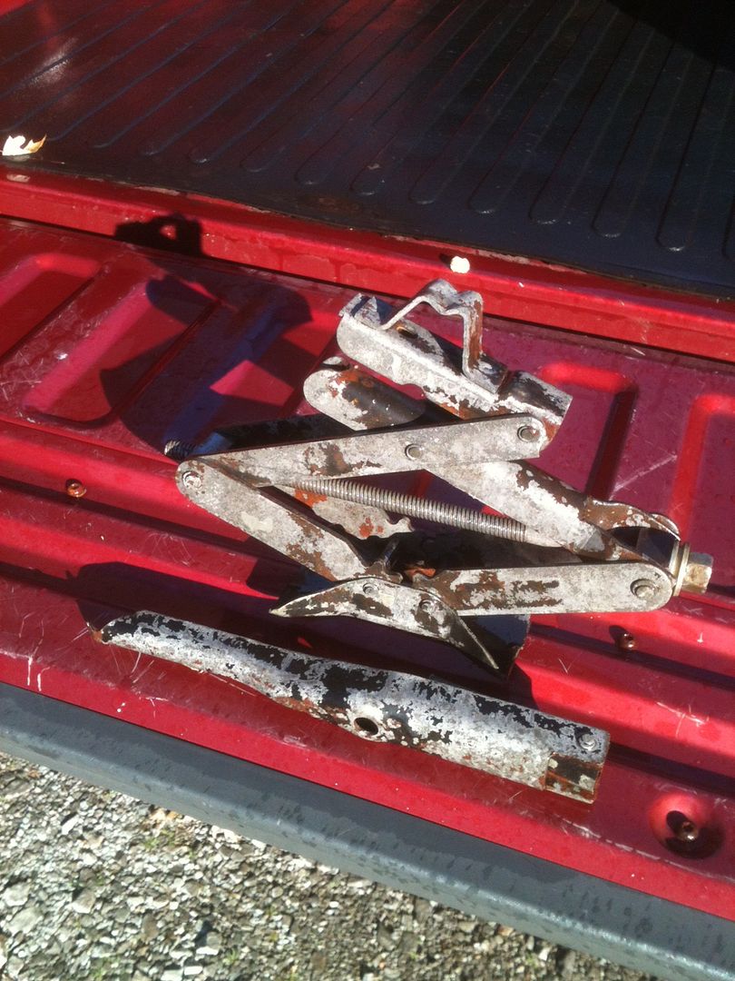

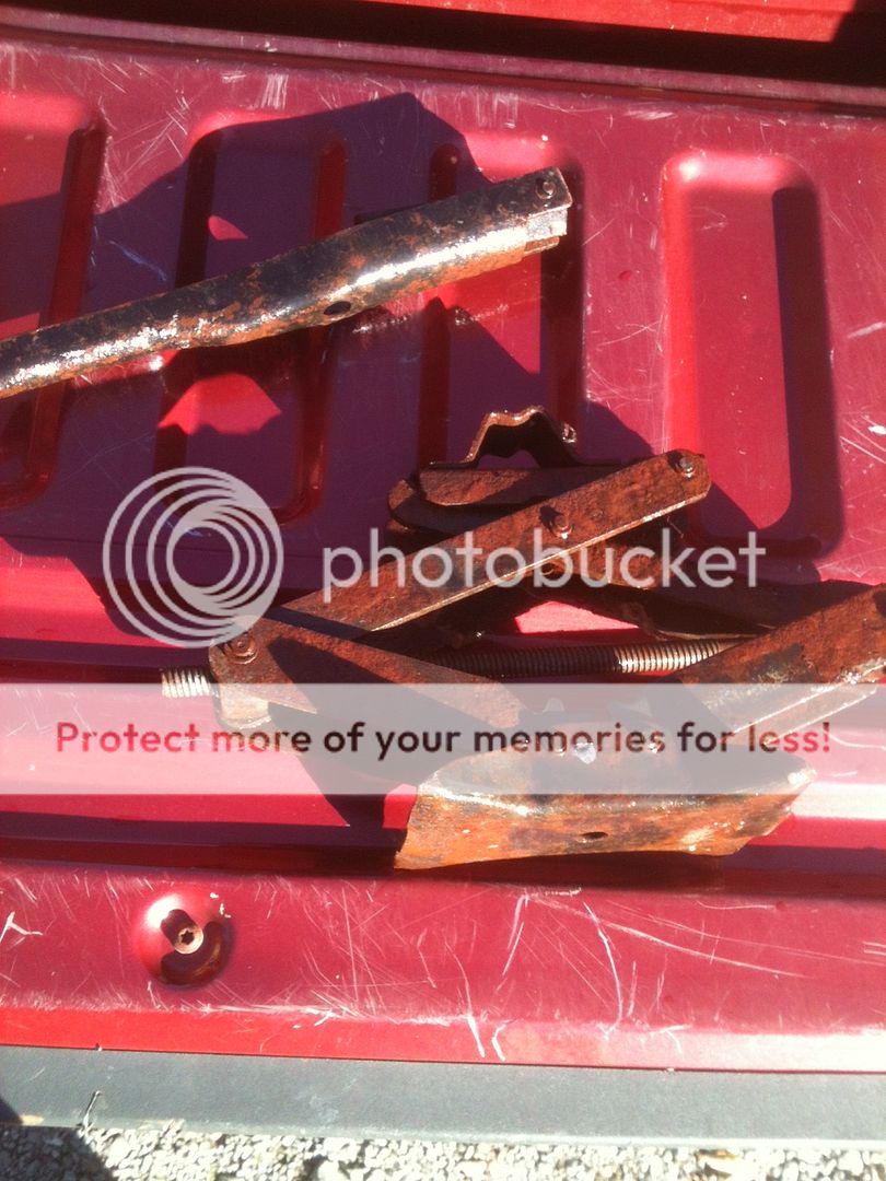

    So it's been almost a week since I sank my rusted up jack in vinegar. I figured that was long enough so I pulled it out to give it a look.
    I was not impressed.
    So then I figured I'd spray of that vinegar and put the jack away. Then as I hosed it off......
    :clap:
    It should be no problem to clean up and repaint now. It even works again!
