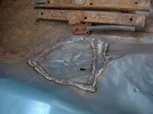

  4. maverick75
    9,014
    I'm not sure if 74 has the catalytic hump, my 75 did and i had to cut if out and make it flat,but you can find donor 74 and up bucket rails and just use those.

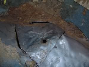

  6. maverick75
    9,014
    The only Crime was not replacing the rusted out floor pan:shhh:
    Its gonna be funny when someone foot goes trough the floor:rolleyes:
