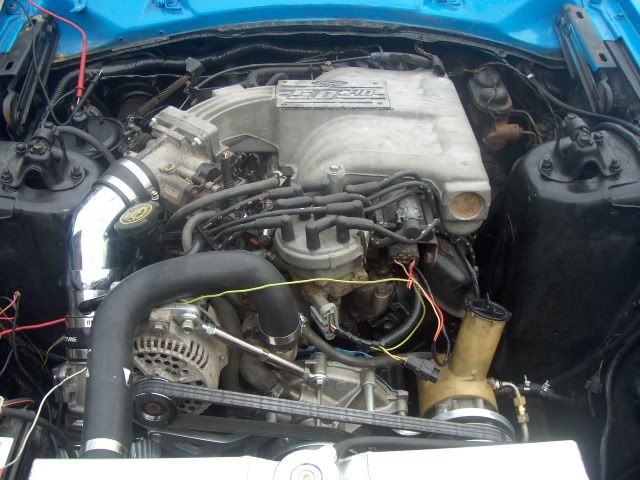

    dunno about HP, but it looks a bit better and doesnt slip as much. just seems like everything runs smoother. i have it on mny blue car...

    wow, that does look nice. I might think about getting a set up, if its truly worth it.

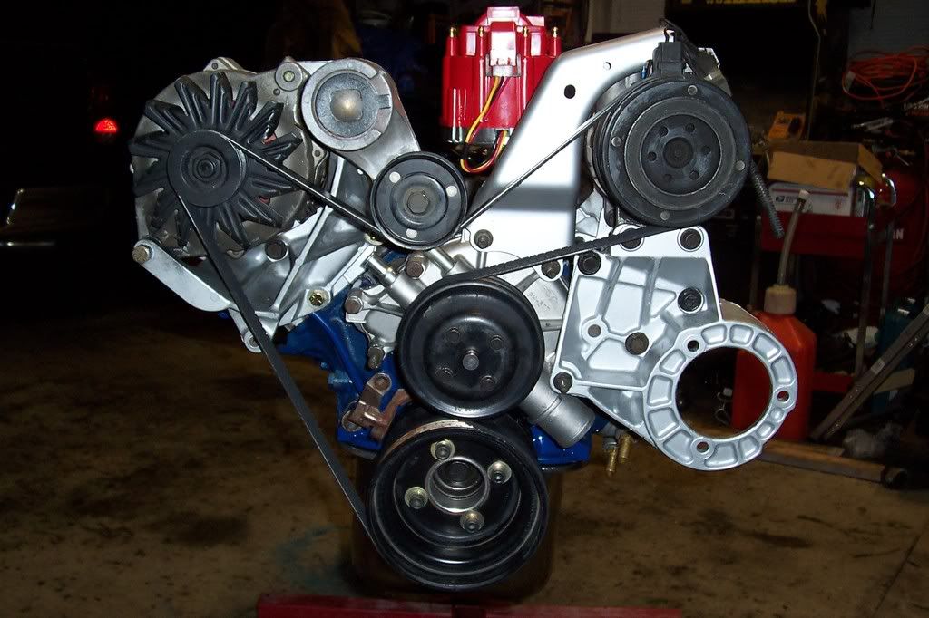

    Here is a pic of the stock JY setup off a 89 Mustang or similar
    You could remove the driverside brackets if you are not going to run A/C

    and they look even better with an EFI setup....

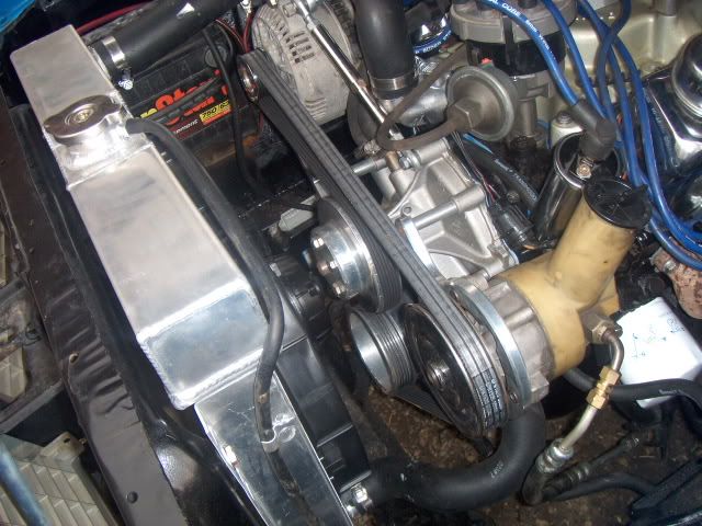

  13. mean_maverick
    reverse rotation water pump, March style brackets from flea-bay, underdrive pullies for a fox-mustang 5.0, cleaned up factory serp belt p/s pulley, powermaster serp belt alternator pulley.
    you can buy kits rather than peicing it together but i had most of the parts laying around from some of my past mustangs so i really only needed the brackets and alt pulley. i also used the newer style p/s pump as well, not necessary but i like the look better. and it all looks better when it's cleaned up... :rolleyes:

  15. mean_maverick
    btw, if u run the underdrive crank and w/p pullies with the standard size p/s and alt pullies, the belt u need is right at 60" (600K6 at my local advance i think).
