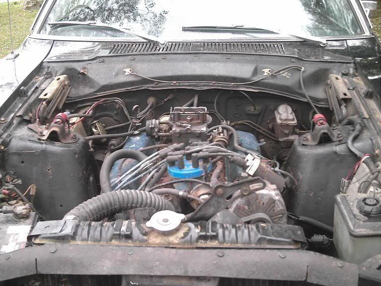

    You cant see mine real well but I have a setup out of a 79 Ford LTD and it works great! The belt runs the water pump, power steering pump and alternator. Plus it all uses a new style power steering pump (the little ones).
