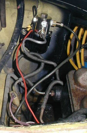

  5. scooper77515
    Here is how I installed it the first time.
  6. scooper77515
    Here it is now, after the MII swap.
    I used more loops this time around for better flexing without potential breakage.

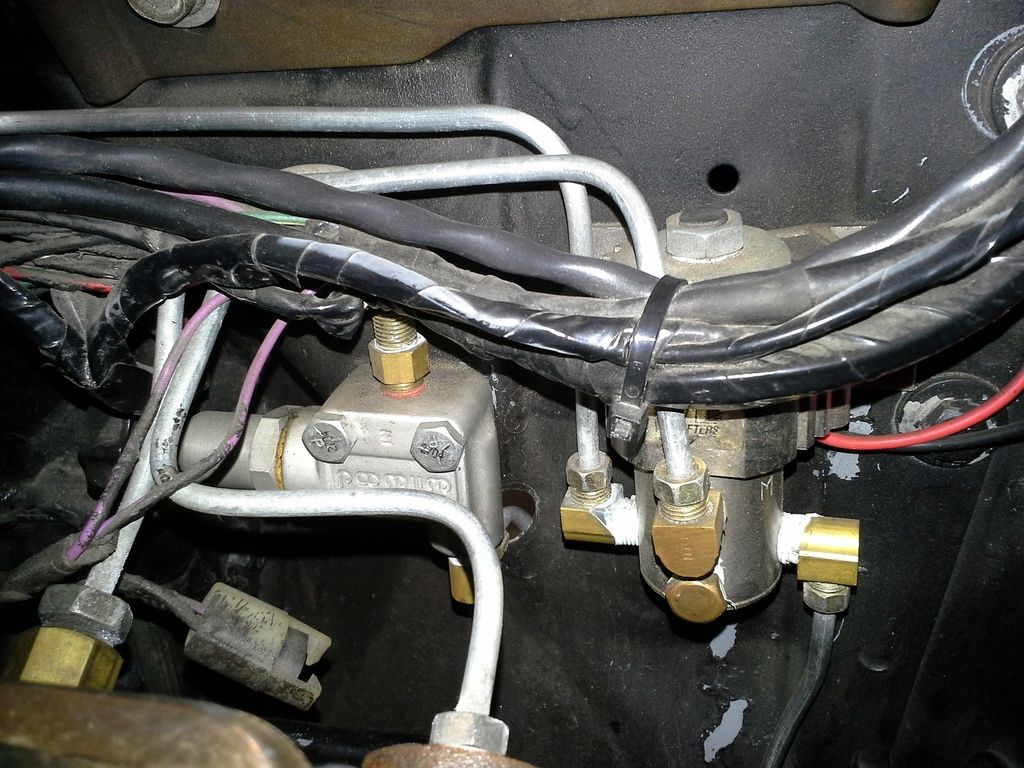

  7. Falcenac
    Falcenac Member
    May 12, 2012
    56
    Sechelt B.C. Canada
    1969.5 Maverick 71 Comet G.T. 76 Comet 4 door 61 Falcon x2 60 Frontenac
    Mounted just below hood hinge. Wilwood adjustable proportioning valve in the mix too.
  8. scooper77515
    Nice professional looking bends...:thumbs2:
  9. mjm0395
    mjm0395 Member
    Dec 2, 2008
    409
    87
    Everett wa
    1972 Yellow Comet, 1966 Ranchero
    Nice ...I also have a proportioning valve so it really gets fun!
