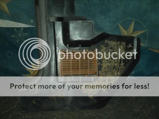

    I have 3-way 6 1/2" pioneer speakers up front under the kick panels. I had to cut out some square holes for the sound to get through and for a little added clearance for the tweeters. Here is some pics of what I have, I still need to find some small factory square speaker grills that I will put on the panels and then I plan on spraying them black with krylon fusion paint.

    The only thing I would recomend is doing it to a spare set of kick panels so that if you ever decide to go back to stock you can. I just took my originals out and put them up. :thumbs2:

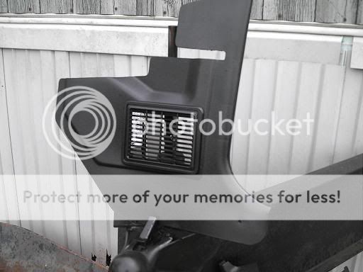

    I finally finished mine today. I cut out around the template on the back side of the kick panel and I used speaker grills out of an old jeep wagoneer. They fit the holes perfect and should be easy to find.

    Yep they are in the front door panels and in the cargo area panels too. I was going to snag an extra set but only the back ones were left.
