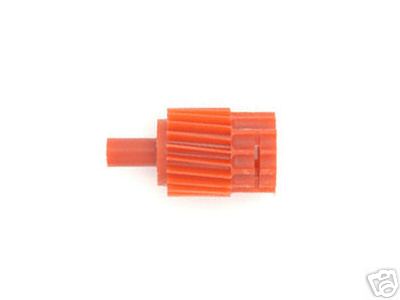

    I don't know if it makes any difference, but the gear I pulled out was smooth where the clip goes and the new one was curved. It was also shorter, and not orange like I thought it would be. But it did have 20 teeth.

    This is what the gear I recieved looks like, except it is white. Is this for a manual transmission?
  5. Mavaholic
    Orange is for an automatic. White is a manual.

    Was the gear a Ford part? A white Ford gear is a 17 tooth manual gear.

    The bag that the gear came in says Speedometer Gear 3SPD + Auto C0DZ-1721-20. It just doesn't make any sense to me. That means it should be a 19 tooth pink gear for a manual.
  13. Mavaholic
    Probably some aftermarket company made that gear and who knows were they come up with part numbers. I can find the formulas for calculation the gear you need if you want. I used them and this chart and got mine within 2mph
