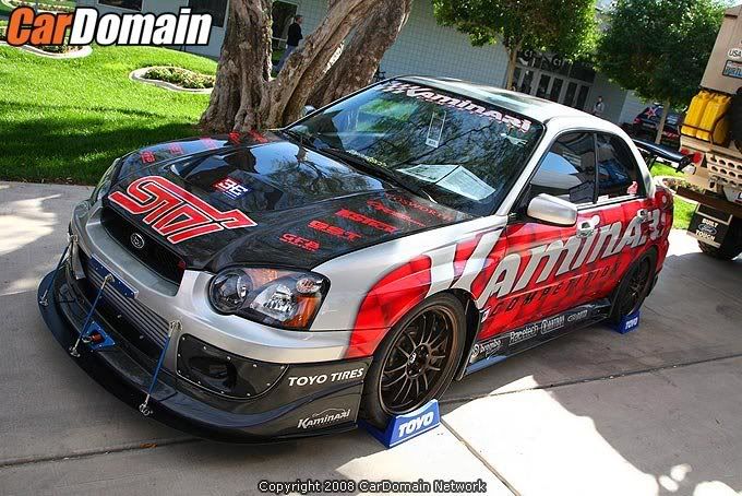

    you can mount it and make it adjustable with some aluminum adjusting rods for air dams and such for rally cars. brace the bottom and put it on a couple hinges. would make it very easy to test at different angles to see what works best
