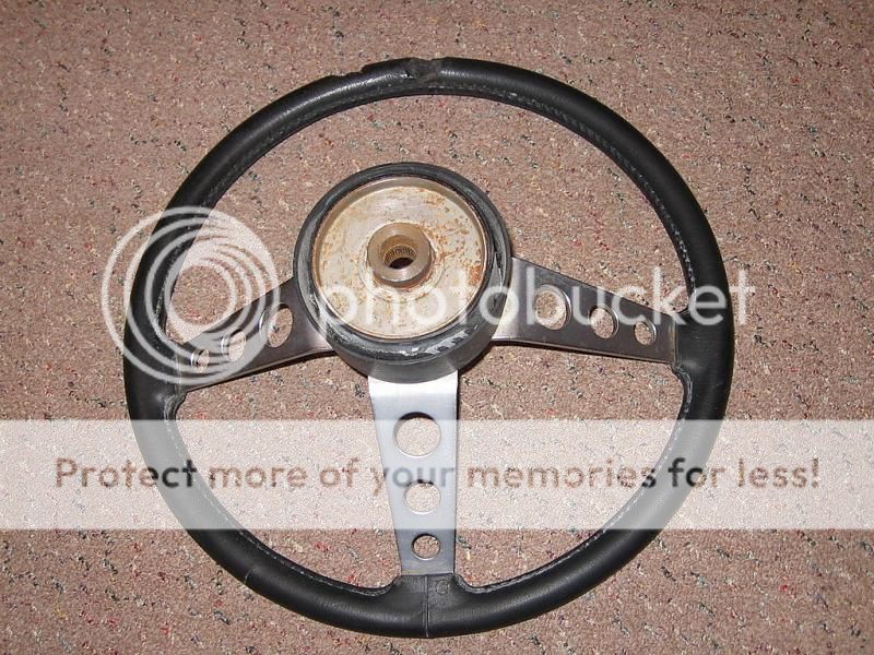

    I recently bought a sport steering wheel off of Ebay and after getting a center button and a Maverick decal from Craig I installed it. It looks awesome!!
    Today since the weather was so nice I took the car out for a cruise. I noticed that when I use my turn signal the lever doesn't return to the home position after making my turn. It only started doing this after I installed the sport steering wheel. I also noticed the steering wheel doesn't lock after taking the key out.
    Is there something I ddi wrong during the install? If not is there a way to fix these issues?
    The steering wheel doesn't have provisions for a horn. I think it came out of a late 70's model Granada or Mustang.
    Here is a picture of it.

    I looked at some pictures of some wheels that were for sale on Ebay. Is the slot you are talking about on the back of the hub?
    That is strange about the turn signal issue then because it worked fine until the wheel swap. I might pull the wheel back off this weekend and see If I see any problems.

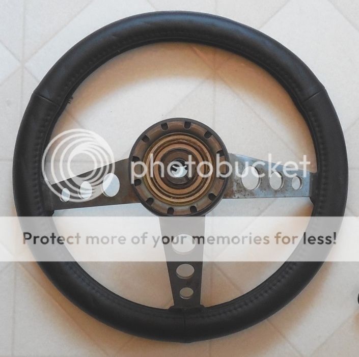

  4. mercgt73
    Locking (notice the slots (holes) around the locking ring). Also has the horn contact ring.
    Non-locking, no horn.

    Alright, I see what you are talking about now. I thought you were just talking about the groove cut in the hub by where the round hole is.
