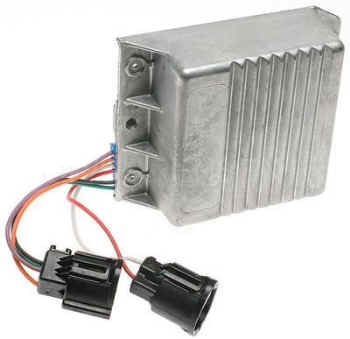

i have also had this happen to me it turned out to be a bad ignition module. i'd bump the switch over and starter would keep going til i got under the hood to disconnect the wire to the solenoid. car would still run great to.
i understand how to run a relay, but i'm looking for a source that will be only active when ignition is placed in on/crank position i don't get how low voltage at the solenoid will make the solenoid not disengage, specially if i tap the solenoid and it stops doing that by ignition module do you mean the ignition switch?

update: went to murray's and exchanged my solenoid, plugged it in, no more running starter i don't have duraspark anymore thats why i was bit confused
