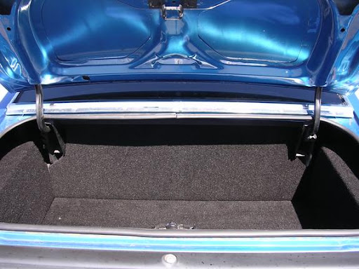

That walmart carpet is same I am using in the trunk. Matches my cut pile in the cockpit pretty well. Chris, do you have an issue with fuel in your carpet? If so, I might add a drip pan or something, because I really want my trunk carpeted and solid floored.
Oh, I thought that was a fuel cell under the carpet. The black thing in the middle at the bottom looks like the opening for a cell.
