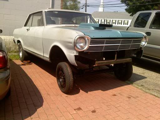

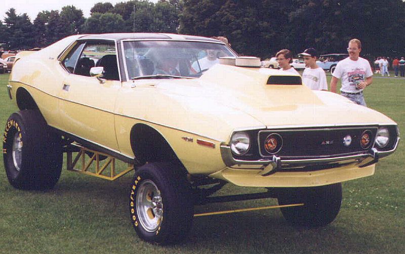

    It can be done quite easily with a kit from Speedway. People do it all the time to Novas, Falcons and early Comets. The look doesn't really fit the era of Mavericks to me, but I can remember several around here in the 70s and 80s. I think it was not so much the gasser look, there was a fad called street freaks. It was pretty gross.
    Gasser from the 60s
    Street Freak of the 70s
  4. mav1970
    The Falcon looks right but the AMC looks like a Hot Wheels or a Zinger :cry:

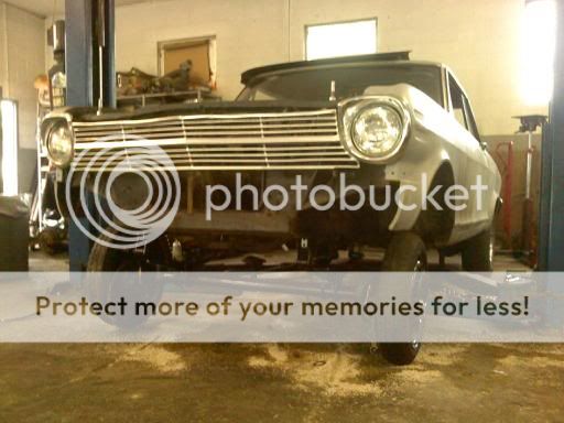

    If you wanted to build a straight axle car on a budget, you can get a front axle from a 2wd Jeep Cherokee. Cheap as heck from a salvage yard...then get some Speedway leafs. Here's a Nova that has one.
