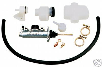

    Ive been looking at a master cylinder that has a remote resevior that i can put anywhere i choose. Hopefully that will work out for me. Will see........
