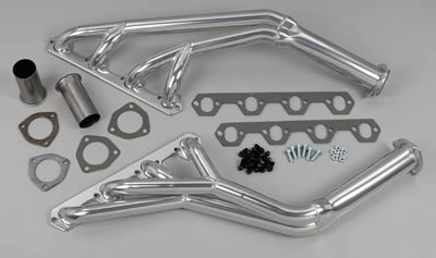

    I need to renew the headers in my Comet soon, I found headers on ebay that I have not seen before. Does anybody have these installed?
    I probably will end up buying the Hooker 6901
    In your opinion should I go with ceramic or painted? and why?

    The headers would sure look great in here:
    More pictures here

    The first headers in that auction will fit a 302 in any Maverick.
    The second set pictured will not fit any engine in any Maverick, no matter what their list says.
    I have tried...
    My take on the coatings is that they are snake oil for the most part.
    I don't know about Thorley, but other header company's coatings suck. Especially Hooker. Folks complain about them flaking and rotting away quickly. The biggest reason is that they don't coat the entire header. Just the visible outside of the tubes.
    If you are sold on coating, then Jet Hot is the way to go. They coat inside and out, every nook and cranny. You can buy your headers uncoated and send them to JH, send them your used headers, or JH keeps a supply of popular headers that they can coat and send out. You can buy Hookers from Jet Hot, with the JH coating, new, cheaper than you can buy new headers from Hooker with Hooker's crappy coating.
    I would ask Thorley if their headers are coated inside and out. If so, they might be okay. I think the difference is between spraying or dipping. Hooker sprays, JH dips.
    In my experience, properly painted headers last a long time. If your painted header doesn't last many years, then you didn't paint it right. Never count on the manufacturer's paint to last, it won't. You have to repaint them yourself. No way around it.
