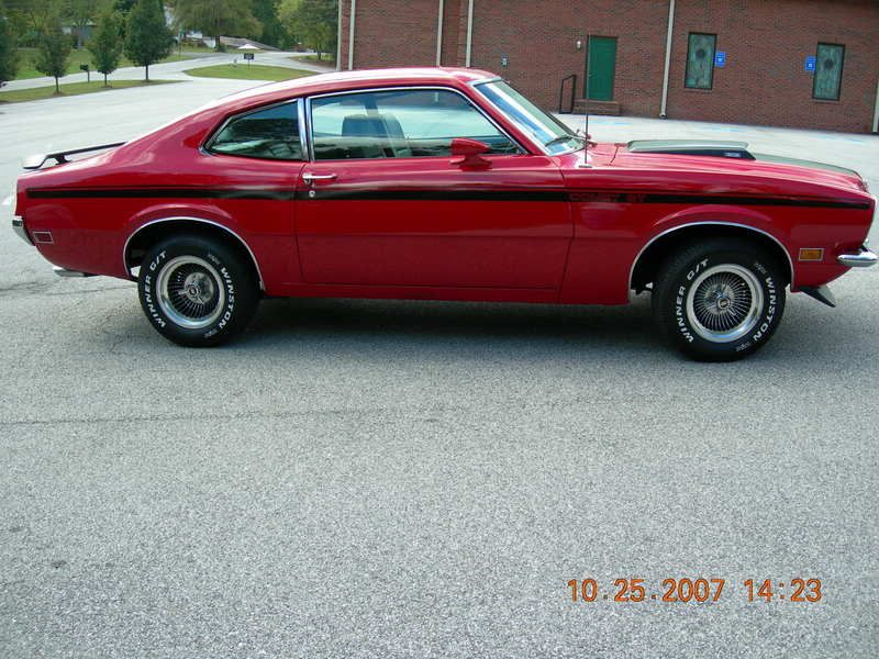

    Mine are 215/60 on 15X7 front, 255/60 on 15X8 rear (see pic). Several sizes will fit, just depends on your personal preference.

  4. scooper77515
    Shouldn't ride any different.
    I have seen late 90s mustangs with 15X7 rims carrying 225/60s all around. and they looked beefy, stout, and aggressive, without looking oversized. I bet many guys on here have similar sized tires. It is a bit wider than the stock (195/70s on 14 rims, if I am not mistaken) but don't look like balloons, yet also don't look like bicycle tires...
    Do a search on the members images and try to nail down what you think looks good, then ask what size they are running. Some may list the tire sizes in the descriptions.
