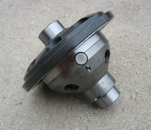

    I cannot afford any rear end mods, and I've got the itch for gears and posi!

    I suggest a minispool , $31 from summitracing. Cures the limpdick peelout.

  8. Bryant
    start looking for a posi in the bone yards
  9. 1973Maverick357
    Nov 16, 2008
    3,082
    89
    Cookeville TN
    What size posi will bolt right in?
  10. Bryant
    any posi out of a 8" equiped ford. mostly found in mustang 2s. the way to check if its a posi is to turn the wheel on one side and one of three things will happen,
    1. the other tire will turn the oppisite direction. this is a open non posi diff. you dont want it
    2. the tire wont turn. this should be a posi. it doesnt turn because the trans. i in park or in gear. put the trans into nutrual. now you should get the third results.
    3. the other tire will turn the same direction. this is most likely a posi. confirm it by puting the trans into park or nutrual and you should get the results listed in #2.

    yeah that's what i was thinking. i heard alot of the old station wagons had posi too ??
