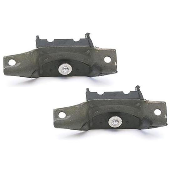

    It ties the two halves together so if the rubber fails the engine will not lift off the frame pads under acceleration or deceleration. You are basically adding a bolt like the one in this picture.

    you'll only need to pin the one side as there is no physical way the other could fail in the same dramatic "hood clearancing" manner.
  12. Bryant
    just to help clarify, the engine twists when you accelerate. this twist stretches the drivers side motor mount and trys to pull it apart. i have found that about 400 hp will rip the parts store replacement mounts in half quickly. so putting a bolt through the mount will keep it from stretching and ripping the mount apart. also the limiting the amount the motor can move in the chassis means more power transferred to the ground.
