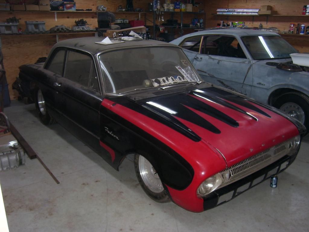

    Everytime i see that Falcon i drool!:bowdown:

    Sold it Sunday. Want to spend more on the '69.5 Pro Stock Maverick and '62 F100 unibody. Think it's going to a good home.
