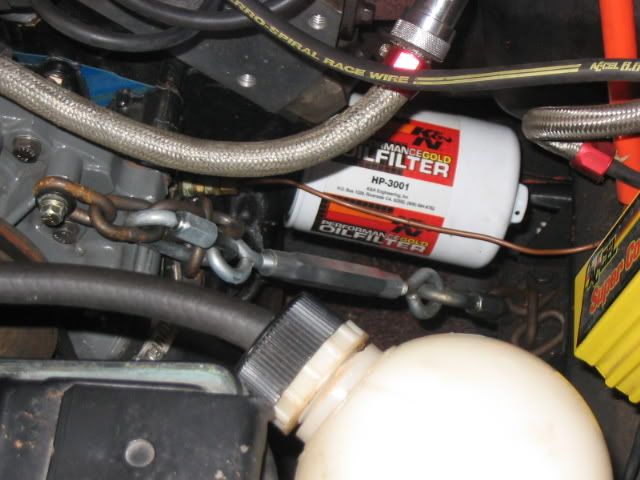

    I know of a couple people that use a turn-buckle.
    It just allows more of the "energy" to go through the drive train and not be wasted on twisting. I am sure its good for a little bit of gains, but I can only imagine that it is minimal gains (but I do not know that for sure).
  5. don graham
    i use one on mine ever since i went down the return road to warm up and hit the gas with no hood on and the air filter came up about 4 inches. went back to the pits and put a turn buckle on, from the head to the hole where the front sway bar was. i ran the race then changed the motor mount. i've had it on there for insurance ever since. also stiffens everything up a bit when you launch.:)

    I run one in the same spot as Don. Allows me to use stock motor mounts without worrying about breaking them and I'm sure it must help the launch at least a bit. the energy that used to rock the motor over must be going somewhere right?
    Anyway, it certainly won't hurt and it's pretty cheap motor mount insurance if nothing else.
