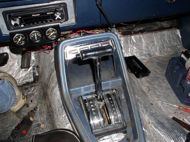

I was wondering about a heat shield...Any suggestions? Something inexpensive that will keep the heat and noise out (not all the noise, I still want to hear my flowmasters when I get them) The carpet just has a jute backing, and all that tarpaper stuff was nasty and I threw it all away.
You can get it at Summit, Jegs, JC Whitney, Lowes. I already had some from JC Whitney, and I was strolling through Home Depot one day and they had water heater blankets -- the same exact stuff, so I bought a roll and put it in the 77. Probably not as good as the more expensive stuff, but it does a pretty decent job. And you can still hear the Flows plenty.
Cool!!! That is what I am looking for. Something that is made "like" the automotive stuff, but not a specialty item "for" automotive...which, for some reason, quadruples the price I was hoping someone would be able to suggest Hardware store items that would work. The JEGS stuff was looking like $50-100 for floor covering, which seems kinda steep considering the carpet was only $125...

Yeah, that stuff. Here is the JC Whitney stuff: http://www.jcwhitney.com/autoparts/...10475/p-2010475/N-111+10201+600002669/c-10101 The only pic I can find of mine installed, before I put the carpet in:
