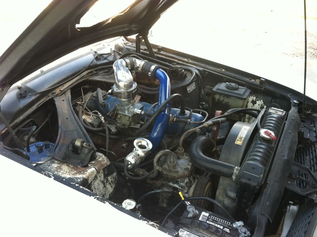

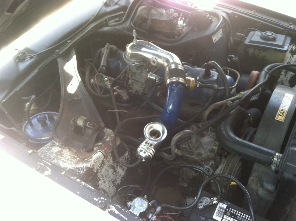

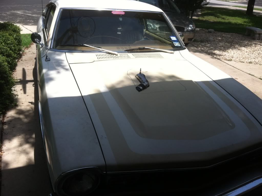

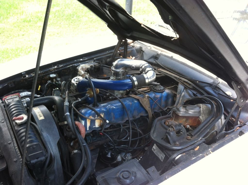

    Here is an update so far. Still need to install hood scoop or go with cowl hood? Hits 5 lbs pulls strong, I need to tune it and get a camera man. http://youtu.be/XjY95vGOLVI

  9. maverick75
    9,014
    Sounds like a blast! Now I'm regretting doing a V8 swap on the falcon :)
    I don't think the head flows enough to max the turbo out, seems like a perfect fit.
    My 200 never pulled that hard! or even close to it!

    Flux core, as in wire welding,and what guage wire please? That is an old carb what brand carb?:tiphat:(y)

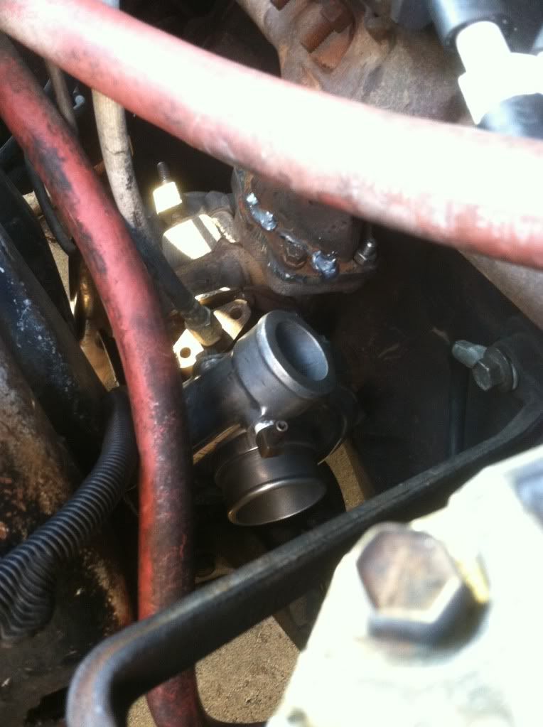

    Did you cut the exhaust manifold in the picture?

    Eastern Raider, I did not cut the cast manifold just created a beveled edge so I could get a good bead in it. The carb is a hybrid carter yfa/yf, the base and center section are from a feedback carb. The top or air horn is from an older yf I had from a jeep. Also the float on the carb is from the yfa since it is a solid float not the hollow brass one found on the older yf.
    Next on my list is to install a water methanol injection kit to see what it will do.

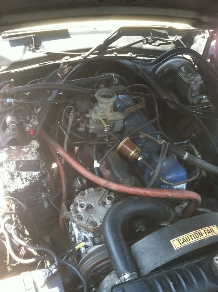

    Just an update on this, it hits 9 lbs of boost however I believe I need to install a boost retard ignition system on it to keep boosting or upgrade the distributor. Either way it rides incredibly smooth with good power, it is very loud and attracts a lot of attention. Sadly I have decided to sell it, I need to free up some cash for another project. If anyone is interested in doing this to their inline 6 please feel free to contact me.
