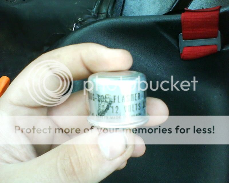

    ok update!!!
    Still not working i change the only thing i could find,this is the part i took out
    it say's on it motorcraft D2AB-13350-AA,also say's tung-sol flasher 12 volts made in canada pat no. 689273

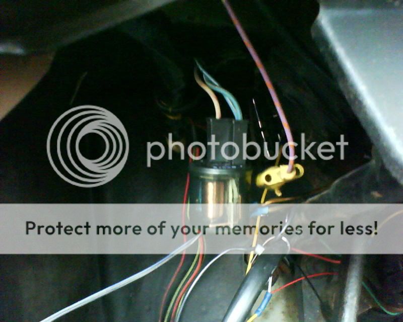

    Here is the plug it came from with a new flasher i got.
  7. maverick1970
    maverick1970 MCG State Rep
    Sep 9, 2003
    7,372
    242
    Missouri
    Based on the wire colors, I would say that is the hazard flasher. The turn flasher wires should be Black-Lt Grn and Lt Blue. The turn flasher is the hard one to reach.
