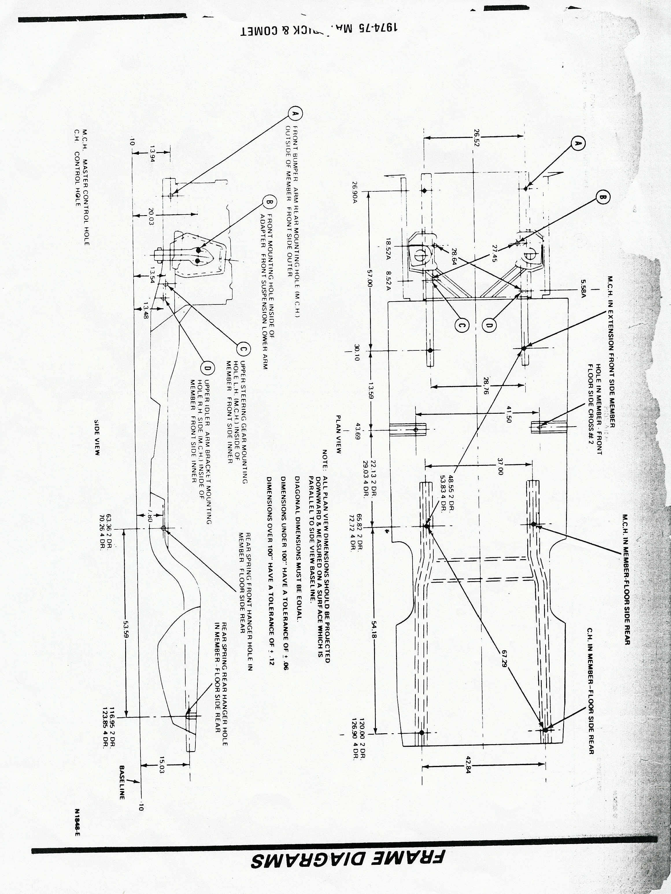

    Does anyone know the inside and outside frame measurements in the front of a 73 ford maverick?
  2. scooper77515
    here is the frame chart...

    will it be the same for a 73?
  5. scooper77515
    I can't see that there would be much differnce between a 73 and 74. As far as I know, the only thing that changed was the size of the bumpers.

    just got the pm everything worked fine thanks
