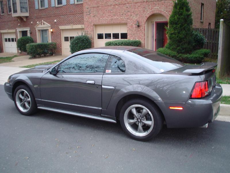

    :rofl2:wow lol well theyre old rims and the dude that had them before me painted it like this diareah orange gold urine color. so im painting them this color
