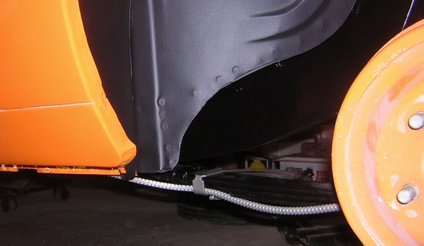

    Undercarriage of car done in Eastwood Chassis Black. Wheelwells done with 3M Undercoating.
