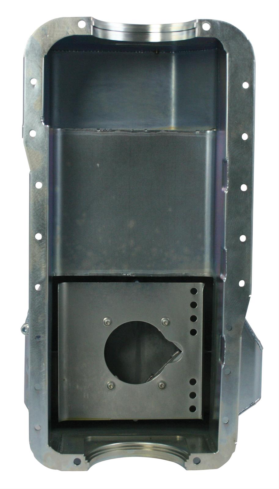

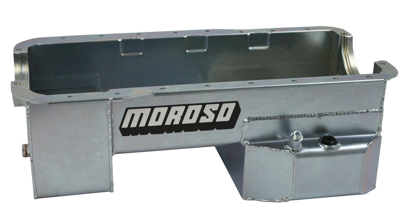

    Brand:Moroso
    Manufacturer's Part Number:20533
    Part Type:Oil Pans, Individual
    Product Line:Moroso Drag/Road Race Oil Pans
    Summit Racing Part Number:MOR-20533
    Rear Main Seal Style:1-piece
    Dipstick Location:passenger side
    Sump Location:Rear
    Stroker Clearanced:Yes
    Maximum Stroke with OE Rod:3.400 in.
    Sump Style:Wet
    Oil Pan Capacity:7 quarts
    Oil Pan Depth (in):7.500 in.
    Oil Pan Material:Steel
    Oil Pan Finish:Clear zinc
    Baffled:Yes
    Kicked Out:Yes
    Kickout Position:passenger side
    Dipstick Provision:Yes
    Windage Tray Included:Yes
    Pickup Included:No
    Crank Scraper Included:No
    Drain Plug Thread Size:1/2-20 in.
    Gaskets Included:No
    Hardware Included:No
    Quantity:Sold individually.
    Notes:Clears all 4-bolt main caps.
    In-Store Pickup:Choose In-store pick-up (OH, GA, NV) on our web site.
    If you're looking for a performance oil pan for drag/road racing applications, then Moroso has you covered! Made with a thick, precision laser-cut steel rail, these oil pans feature a 7 quart capacity that moves oil away from your rotating assembly, offering excellent oil control and horsepower savings. Their race-proven diamond shape, four trap door assembly, and anti-slosh baffles keep your oil contained in the oil pump pickup area during road and drag racing. Moroso drag/road race oil pans have a billet aluminum adapter with a 1/4 in. NPT sensor port that allows a 13/16th thread Moroso or OEM filter to be mounted in the stock location--no need to run a remote oil filter! These pans use a stock dipstick.

    Good point but I am a little concerned about clearing the rack. The ones I found have a slight angle and are rounded..

    I used the 7 qt pan (Moroso, I think) and ended up having to redo all the exhaust because of it. Long tubes would not clear the enlarged lower portion.
    The regular 5 qt one would have been no problem.

    I like the Moroso with the kickouts(like in ebay link you listed), the baffling looks great too
