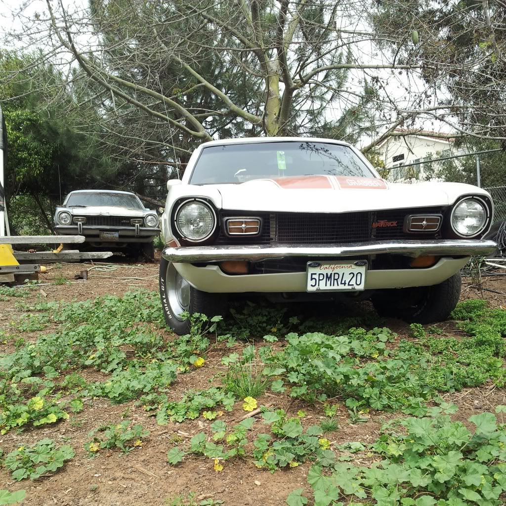

    Here's a picture of the front

    1971-1972 Grabber light lens is CLEAR with an amber bulb.

  11. 71gold
    2,935
    turn signals in grill...clear lens w/amber bulbs. lights under bumper are clear lens, clear bulbs converted to fog lights...they come on with headlights high/low...:thumbs2:

  13. Bryant
    so then the amber lens lights in the grill above are for 73 and newer cars that didnt have the skinny bumper?
  14. 71gold
    2,935
    suppose to be a...71-72 Grabber grill...:yup:
