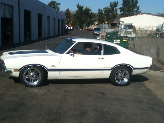

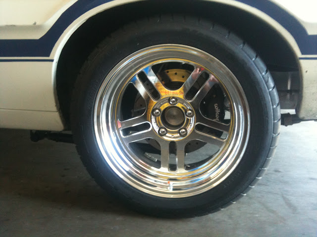

  10. Bryant
    mashori has 275 40 17s on the rear of his car. we had to roll the fender lips and push them out about 1/2 an inch.
