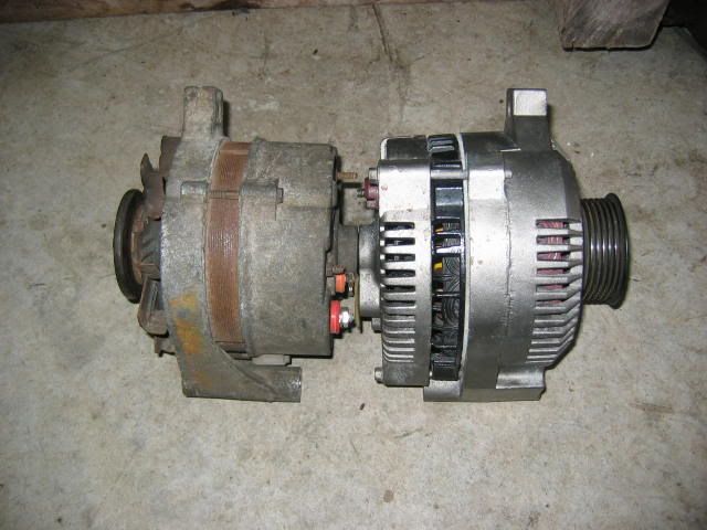

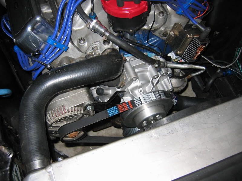

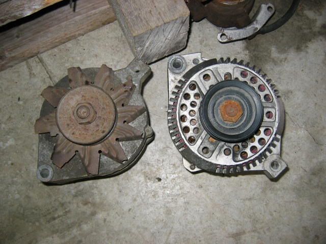

    Here are some pics too compare the 1G versus the 3G alternator
    You can see the 3G alternator has a bigger case then the 1G but the mounting brackets are very similar too each other. The reason that the 3G alternators case is bigger is due too the cooling fan for the alternator, on the 1G the cooling fan is outside the case the 3G is inside the case making it a longer lasting alternator.
    As you can see in this picture how close the mounting points are in comparison too the 1G and the 3G, notice he is using what appears too be the stock alternator brackets
