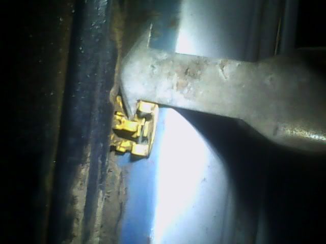

You can get the tool at any harbor freight store. It comes in a 3in1 trim kit for around 3 bucks. Heres a pic of the tool and the molding clip: sorry for the quality.
Just for reference....the above picture shows the tool being used on the wrong side of the trim. It should come in from the glass side.
Thanks for the clear up Craig, its been years since i did it. In the top of the glass its set up like that but i couldnt remember what part of the actual clip that you have to pull on.
