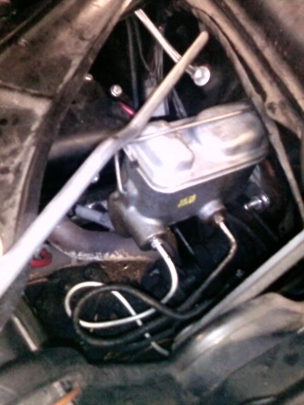

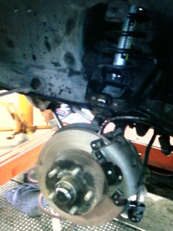

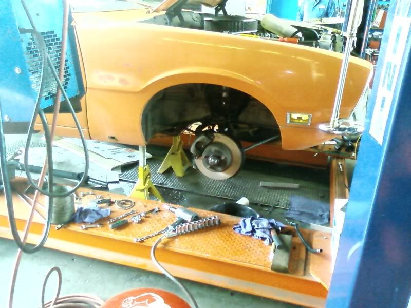

    Spindles out from a 1973 Mustang bolted right up. Same tie rods on both cars so the taper was correct. Parts are cheaper than Granada if I remember right. (had this stuff laying around a long while)
    Had to have brake hoses made up for about $20 a side. I put in a master cylinder from a later manual disc Maverick and had to make a new hard line for the rear brake circuit, but the one for the front screwed right in.
    Transmission is out of the car, so I can't tell you how well the brakes work yet, but it was an easy task.

    that is the same master cyl. i just put on my car..i cut the fitting off and put the correct one on.:yup:
    today "the boy" and i bled the brakes..Chris made the comment that the brakes felt better than they did..he knew i put on a new m/cyl. but he didn't know i put on a diff. one.:yup: the one before was a ...drum/drum m/cyl.

    Re: Yet another front disc option
    Hey 71Gold,
    I am just double-checking because I am about to do the same thing on my '73. It currently has 4 wheel drums.
    You used a manual master cylinder for a front disc / rear drum car?
    And you didn't need to add a proportioning valve?
    Thanks in advance for a reply,
  7. 71gold
    71gold Frank Cooper
    I used a manual master cylinder for a front disc / rear drum car.
    ...proportioning valve... some do...i didn't (y)

    I probably won't either. I'll post my results after I've hauled it down from tripple digits.

    I first used mine with out the prop valve, then added an adjustable one. Could not tell any differince. Made several adj, still no differince.
    Hi - and thanks to all who responded with their experiences!
    I hope I am as lucky as you folks - and I won't need to add a proportioning valve, either!!!

    Look'in good!
    Did you notice a change in the offset (ie: do the wheels now stick outboard more)?
    PS: I must have been out of the loop for a while...when did you get the killer paint job?

    Actually I measured it out and it pushed the wheels out about 1/8th in.
    Not enough to bug me.

    That is interesting...
    I never noticed.
    They (73 spindles) are the same as MANY Ford/Merc spindles from 68-73.
    There are 2 different bearing sizes, but that is the extent of changes.
    Also, drum spindles from Mavericks and those same cars are even the same part number. So if it pushes out 1/8" going drum to disc on our cars, it would do the same when going drum to disc on the others.
    Anyway, I think the wheels should set wider on the front of a Maverick anyway. So IMO, it's a good thing.:yup:
