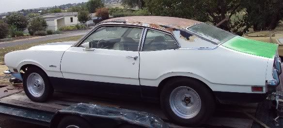

    [​IMG]Here is my 74 with 246/60/14 on the back and 235/60/14 on the front[​IMG]

    I'm using 235-60-14's on factory 6" wheels.

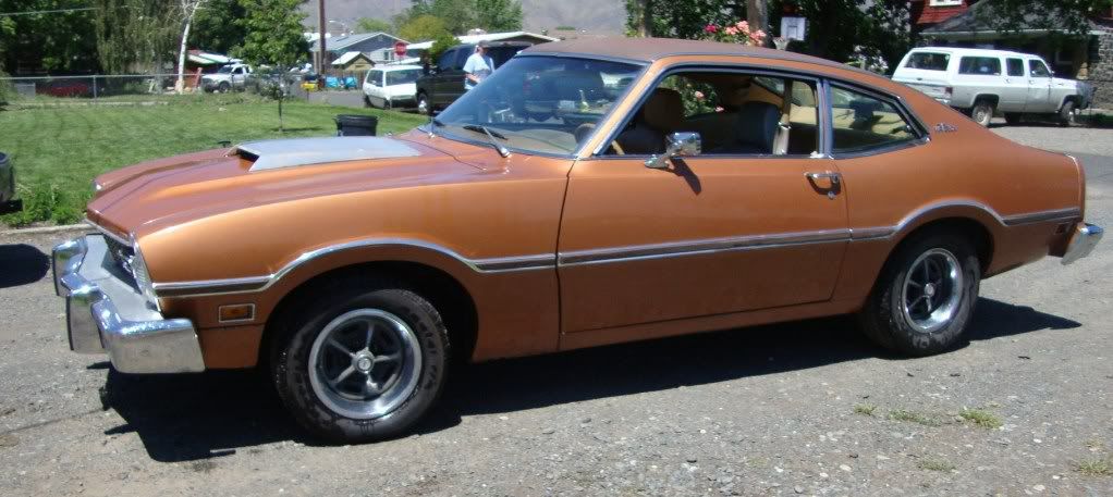

    found a different angle sorry mot the best photos[​IMG]
  7. Dave B
    214
    Thanks for the pic's! A 60 series tire just looks small...I may wait and find some 1991 Crown Vic 15" steel wheels, and see what works with them.
