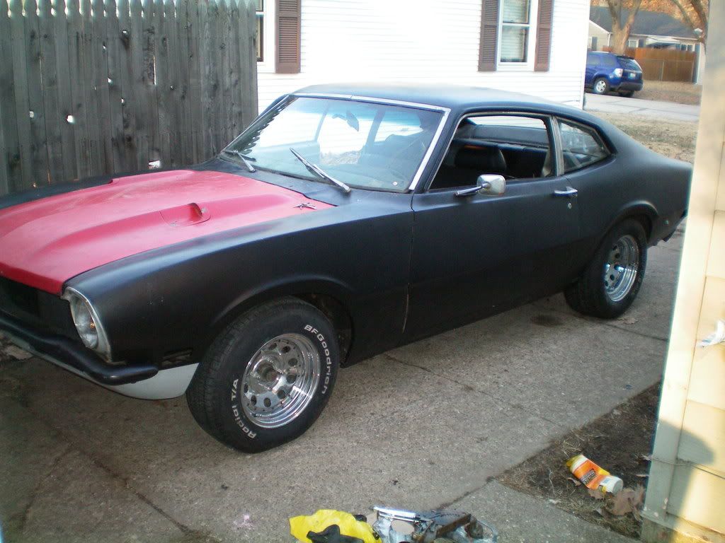

    my car went from this
  11. mustangturbo50
    mustangturbo50 Member
    Sep 19, 2007
    143
    bettendorf, ia
    71
    to this
    im so happy with the progress.. i guess im just so excited because i had a 74 maverick when i was 16 and always wanted to restore it but never had the chance. now im getting to do one the way i want. kind of a dream i guess....
