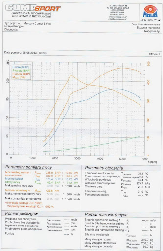

    Now I know... and I am a bit dissapointed, my stock 78 Vetta has better performance :)
    Only 235 bhp and 426 Nm of torque

    that's not too bad, as the stock 85 engine was rated 210 hp an 270 lb ft.
    but it looks like the engine is close to stock, so i would consider an upgrade, too.
    as you have a 302 already in there, i would stick with the sbf. thus, you can reuse your headers and exhaust. for anything bigger than the 351, you would have to modify the shock towers.
    do what bryant suggested, buy a 'kit' from a reputable engine builder and put it together yourself.
    otherwise, look for some input as far as compression, heads and cam is concerned and work with your existing block. you will want to start with a roller block anyway.
